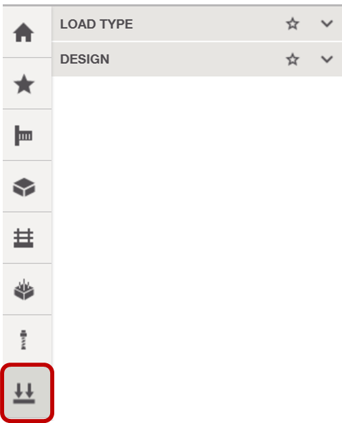

  1. Go to Loads / calculation type
    In your Shear strengthening design workspace, go to the Loads /calculation type on the left-hand side of the screen.

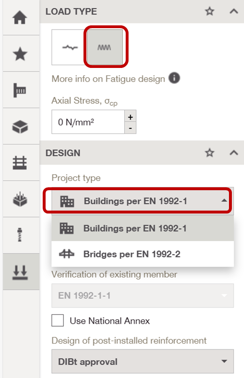

  2. Expand the Load type section

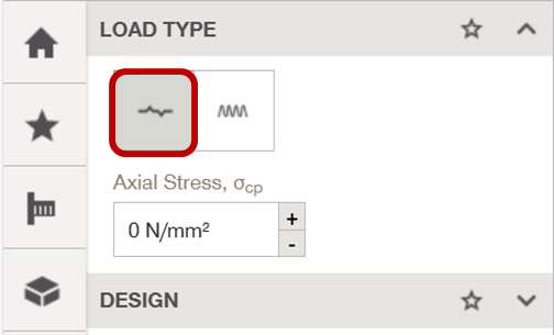

    Navigate to Load type and select the desired option.
    Here you can choose between:
    • Static load
    • Fatigue load
    The Static load option is enabled by default.
    If you select Fatigue design, an information icon (i) appears with additional guidance about fatigue considerations.

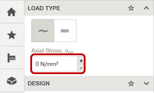

  3. Input Axial stress (if applicable)
    Enter the Axial Stress value using the input field or the + / – buttons.

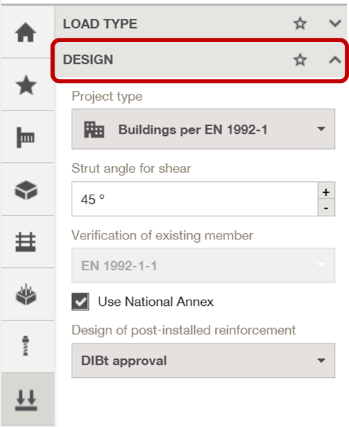

  4. Expand the Design section
    Navigate to Design.
    Here you can:
    1. Select project type (if applicable)
    2. Enter the strut angle for shear
    3. Enable use of National Annex for design
  5. Select the project type (if applicable)
    This option is enabled only when fatigue load type is selected.
    Use the Project type dropdown to choose between:
    • Buildings per EN 1992‑1
    • Bridges per EN 1992‑2

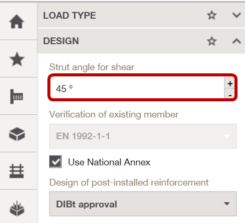

  6. Enter the Struct angle for shear
    Enter the Strut angle for shear value using the input field or the + / – buttons.

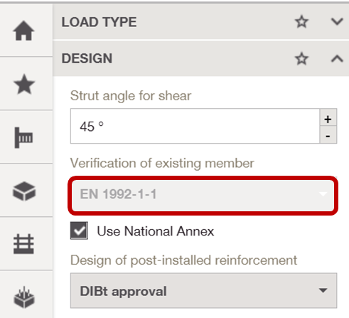

  7. Select the verification method for the existing member
    The Verification of existing member field (e.g., EN 1992‑1‑1) appears locked, as it corresponds to the chosen project type and region.

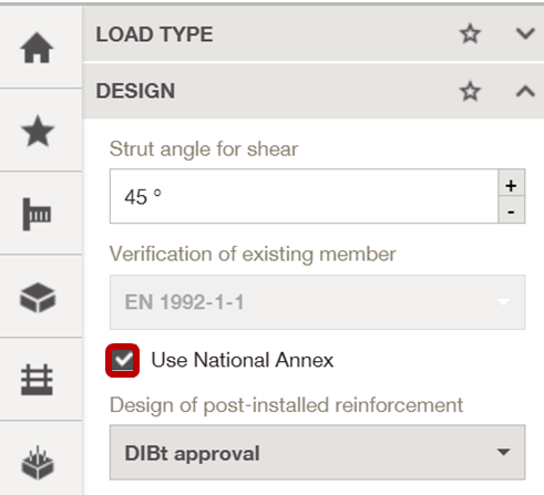

  8. Enable National Annex (optional)
    Enable Use National Annex if your project follows country‑specific Eurocode modifications.
    This adjusts partial factors and verification rules based on national implementation.

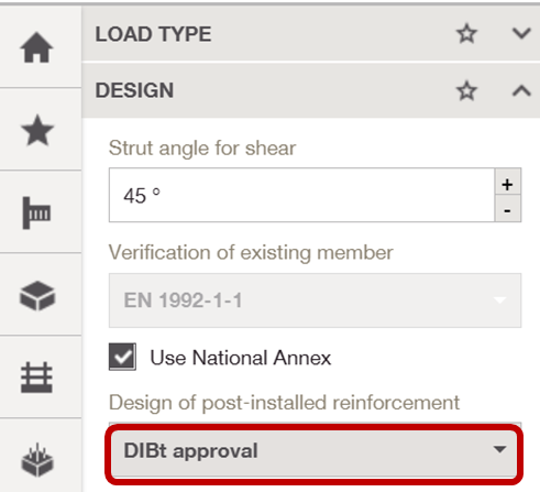

  9. Select the design method for the post‑installed reinforcement
    Use the dropdown under Design of post-installed reinforcement to choose the approval basis, such as DIBt approval.
