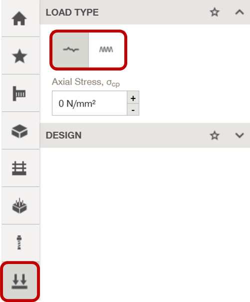

  1. Select load type
    In your Shear strengthening design workspace, go to the Loads /calculation type on the left-hand side of the screen.
    Select the Load type.

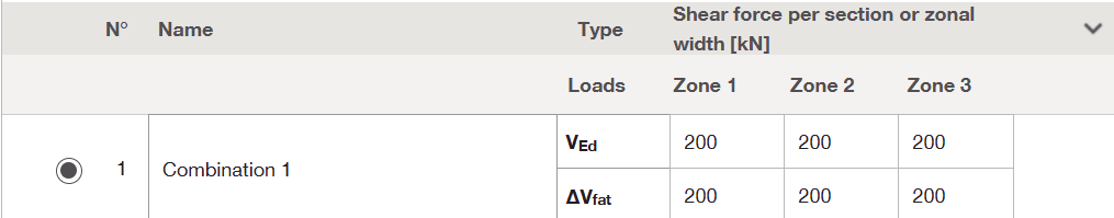

  2. Go to the load combination panel
    In your Shear strengthening design workspace, navigate to the Load Combination panel located at the bottom of the screen.
  3. Input loads
    Depending on the selected load type, enter values under:
    • Static load
      • Shear force per section or zonal width
    • Fatigue load
      • Maximum shear force
      • Fatigue shear variation

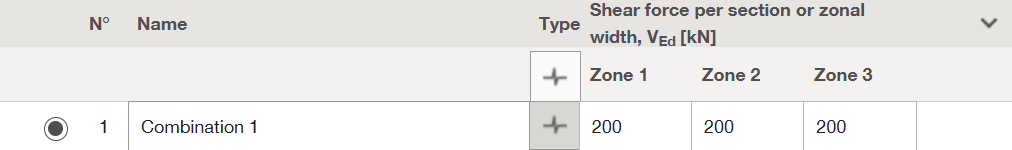

  4. Modify an existing load combination
    • Click directly inside any value field (Zone 1, Zone 2, Zone 3, etc.)
    • Update the load using direct input or overwrite the value
    Changes take effect immediately and update the design checks.
Defining zone‑specific loads improves design accuracy and prevents over‑ or under‑strengthening.
