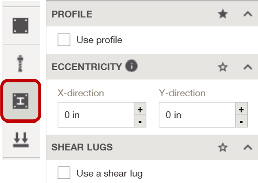

  1. Open the Profiles tab
    In your Anchoring to Concrete design workspace, navigate to the Profiles tab on the left-hand side of the screen.
  1. Enable the Shear lug option

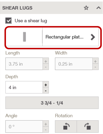

    Under Profiles, enable the Use a shear lug option if you intend to include a shear lug.
    Choose the desired shear lug from the available predefined options.

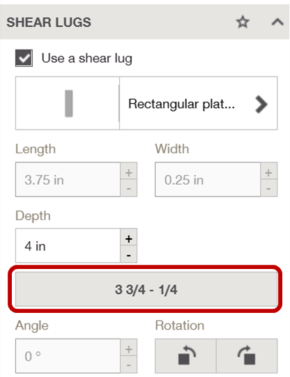

  2. Select the Shear lug size
    Choose the required Shear Lug Size from the dropdown menu.

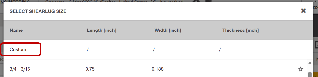

  3. Define a custom profile (optional)
    If you need a non-standard configuration, select Custom to define your own profile parameters.

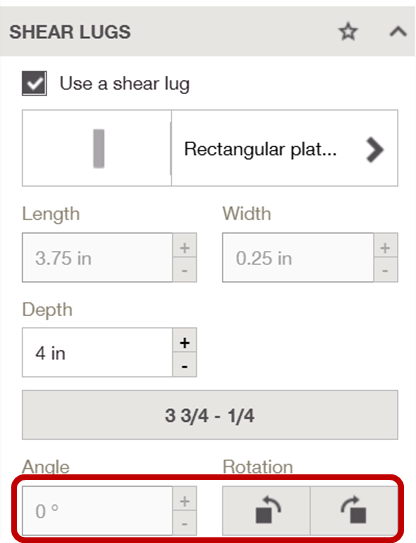

  1. Adjust the Shear lug orientation
    Use the rotation controls to turn the shear lug left or right.
    Each click rotates the shear lug by 90 degrees.
