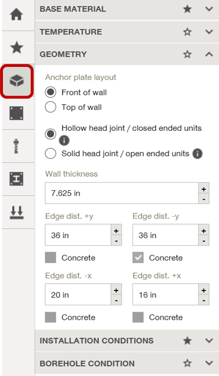

  1. Open the Base material tab
    In your Anchoring to Masonry design workspace, navigate to the Base material tab on the left-hand side of the screen.

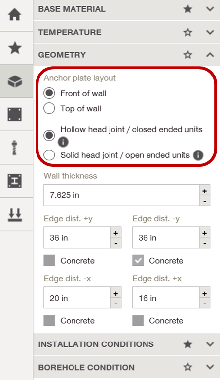

  2. Modify Anchor plate layout
    Expand the Geometry sub‑section.
    Under Anchor plate layout, select the appropriate position.
    Use the information icons (i) for additional definitions when needed.

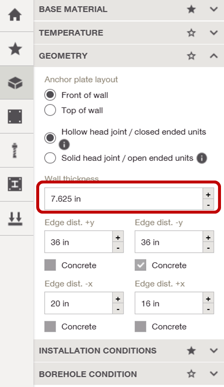

  3. Enter wall thickness
    Type the wall thickness directly into the input field or use the + / – controls to adjust the value incrementally.

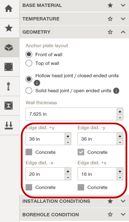

  4. Define edge distances
    For each direction, enter the required edge distance.
    Use the checkboxes when you would like to lock the edge distance in a specific direction.
