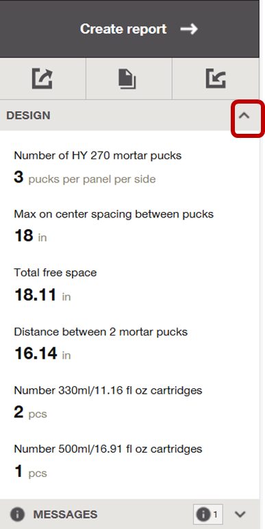

  1. Go to the Results and Notifications panel
    In your Glass Balustrade design workspace, go to the Results and Notifications panel on the right-hand side of the screen.
  2. Open Design section
    Expand or collapse the Design section using the arrow next to it.
    Here, you can review the design results based on your inputs.

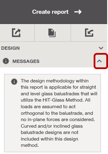

  3. View Notifications
    Open the Messages section to review design tips, warnings, and error messages.

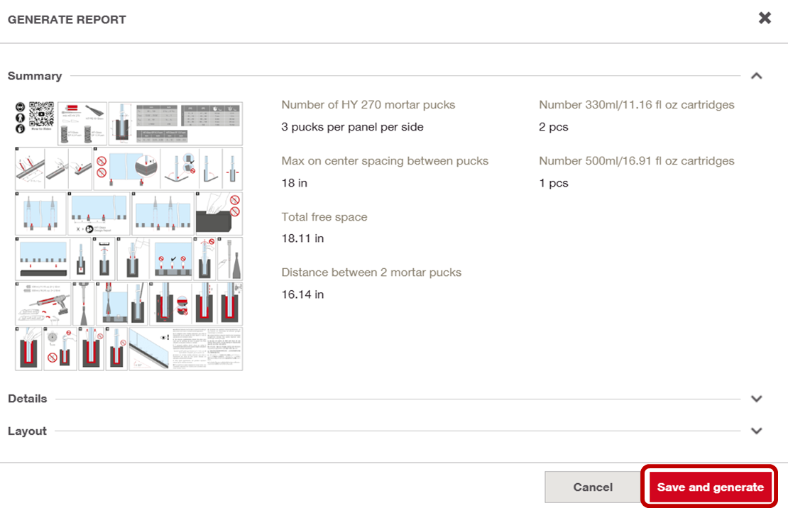

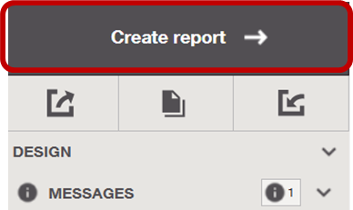

  4. Save and generate detailed design report
    Click Create report on the right-hand side of the screen.
    In the pop‑up window, customize as needed, select Save and generate to create a full detailed design report.
