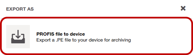

  2. Save the PROFIS design file
    Choose PROFIS file to device.
    The file will be automatically saved to your downloads folder or your predefined system folder.
