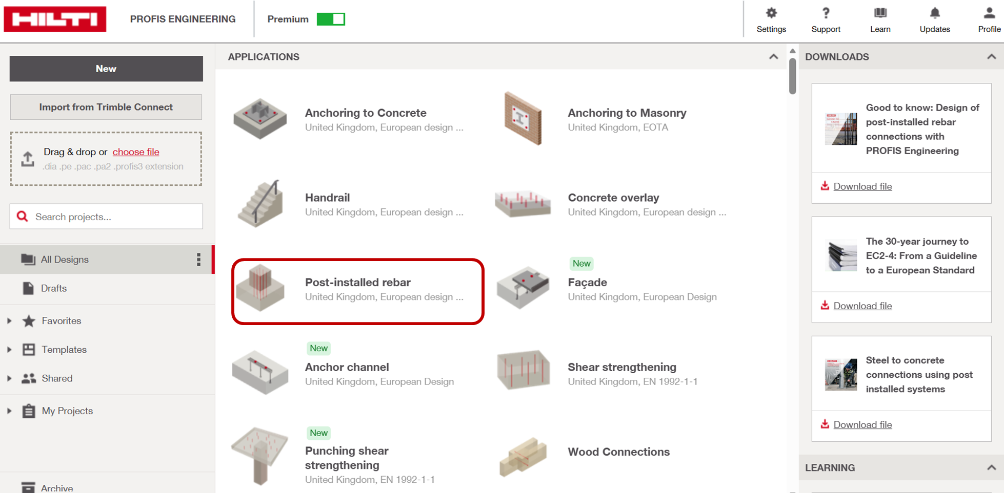

  1. Go to the PROFIS Engineering website
  2. Log in to your account
    Enter your Hilti credentials to access your workspace.
  3. Open the Post-installed rebar module
    Click New in the top-left corner.
    From the available options, select Custom design.

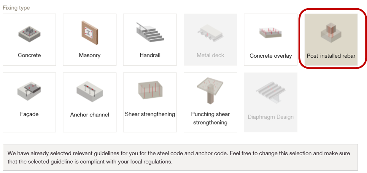

  1. Select the fixing type
    Choose Post-installed rebar from the fixing type options and click Save.

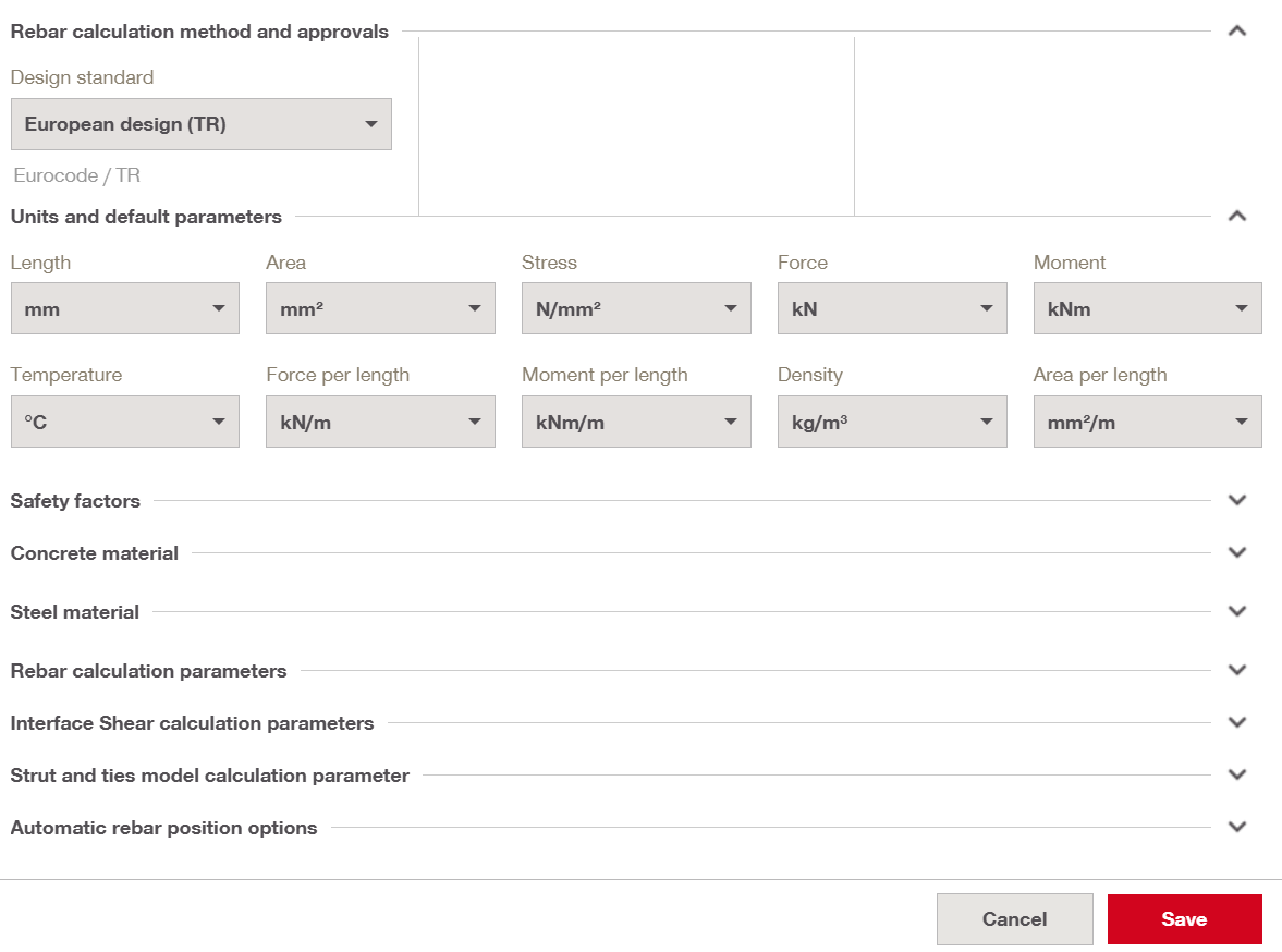

    Here you can also set your default design standard and units.
  2. Customise settings (optional)
    If needed, adjust:
    1. Rebar calculation method & approvals
    2. Units
    3. Safety factors, calculation and default parameters
    Click Save once finished.

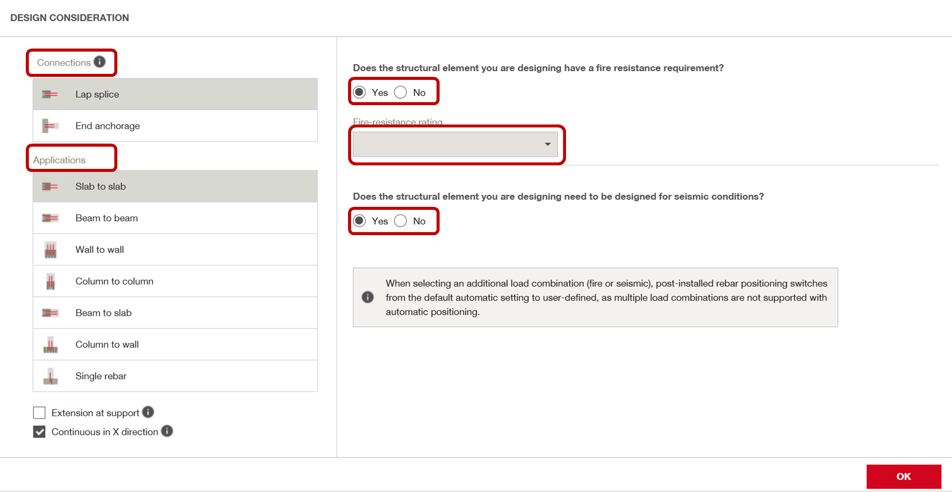

  3. Input design considerations
    In the pop-up window, select your connection type, application, and any fire or seismic requirements.

Alternative access method
On the PROFIS Engineering home page, you can also click the Post-installed rebar tile directly under the Applications section in the center panel.
