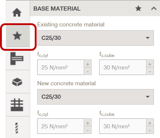

  1. Open the Favourites tab
    In your Post-installed rebar design workspace, navigate to the Favourites tab on the left-hand side of the screen.  Here you can view all inputs currently marked as favourites.

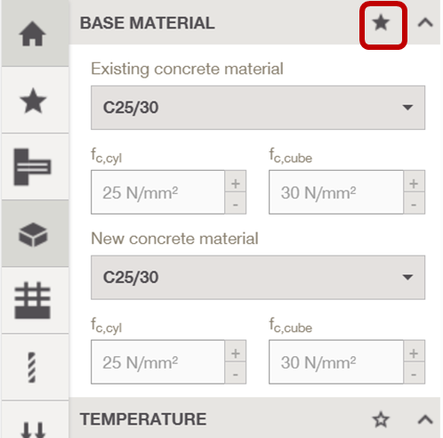

  2. Add or remove favourite inputs
    Go to any design input tab on the left.
    Click the star icon at the top of the input panel to add it to Favourites.
    Click the star icon again to remove it from Favourites.
    Tip
    You can rearrange your favourite inputs by right-clicking an item and dragging it to your preferred position. This helps organize your workflow for faster access to frequently used settings.
