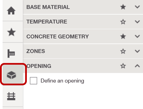

  1. Open the Base material tab
    In your Shear strengthening design workspace, navigate to the Base material tab on the left-hand side of the screen.

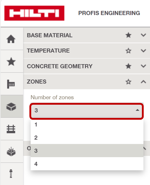

  2. Enter Number of zones
    Go to Zones.
    Here you can select the Number of zones from the dropdown list.

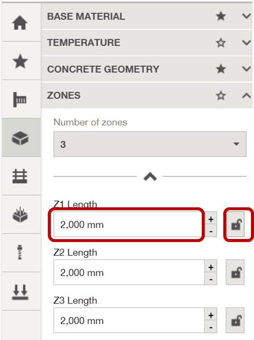

  3. Enter length of zone
    Enter the length for each zone.
    You can choose to lock the length value by clicking on the lock icon next to the length.
