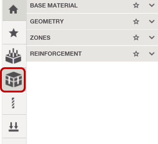

  1. Open the Concrete member tab
    In your Concrete overlay design workspace, navigate to the Concrete member tab on the left-hand side of the screen.

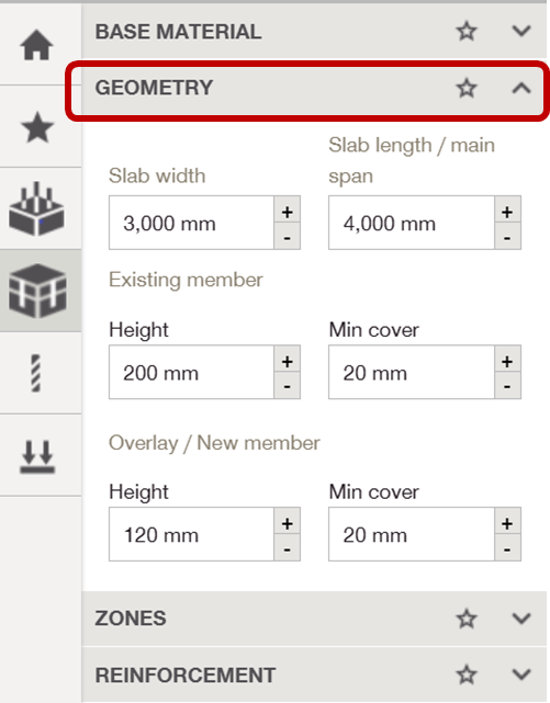

  2. Go to Geometry
    Here you can type in the dimensions of the existing and new concrete member. Alternatively, use the “+ / –” controls to increase or decrease the values.
    Note: The input field change depending of the selected application.
