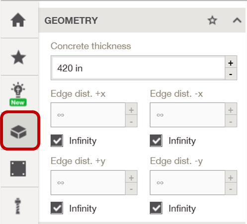

  1. Open the Base material tab
    In your Anchoring to Concrete design workspace, navigate to the Base material tab on the left-hand side of the screen.
  1. Go to Geometry
    Here you can type in the concrete thickness value and edge distances in x and y directions. Alternatively, use the “+ / –” controls to increase or decrease the values.
  2. Use the infinity edge option
    Select the Infinity edge option in case of large edge distances.
If your concrete member geometry is not yet finalized, start with approximate dimensions and refine them as your project develops. Changes to thickness or edge distances can significantly affect anchor capacity, so update the geometry whenever project drawings or site conditions change.
