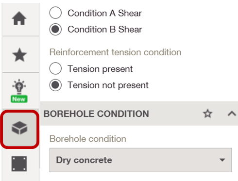

  1. Open the Base material tab
    In your Anchoring to Concrete design workspace, navigate to the Base material tab on the left-hand side of the screen.
  1. Go to Borehole condition
    Select the desired Borehole condition from the dropdown menu.
