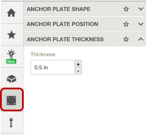

  1. Open the Anchor plate tab
    In your Anchoring to Concrete design workspace, navigate to the Anchor plate tab on the left-hand side of the screen.
  2. Go to Anchor plate thickness
    Here you can type in the thickness value or use the “+ / –” controls to increase or decrease it.
Tip
The influence of anchor plate thickness may differ depending on the chosen design method. It is minimal in the case of rigid design (i.e., anchor item selection) but is significantly considered in advanced CBFEM methods, as it affects the connection stiffness, thereby impacting load distribution and the design of various connection components.
