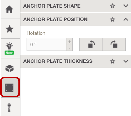

  1. Open the Anchor plate tab
    In your Anchoring to Concrete design workspace, navigate to the Anchor plate tab on the left-hand side of the screen.
  2. Go to Anchor plate position
    Use rotation controls to turn the anchor plate left or right. Each click rotates the plate by 90 degrees.
