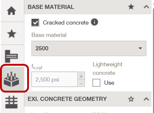

  1. Open the Installation Conditions tab
    In your Concrete to Concrete design workspace, navigate to the Installation conditions tab on the left-hand side of the screen.

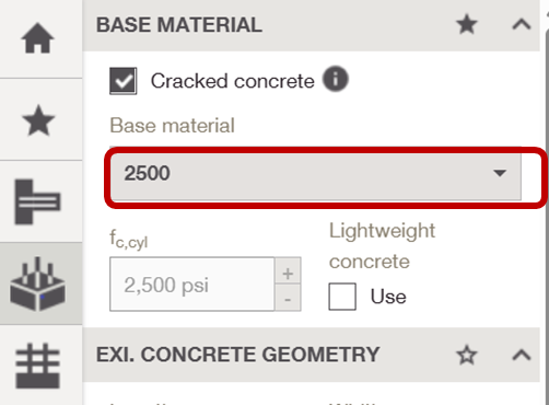

  2. Select concrete grade
    Choose the appropriate Concrete grade from the dropdown menus.

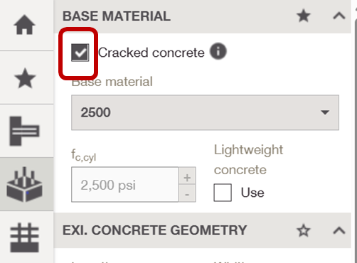

  3. Define cracking condition
    Cracked concrete option is enabled by default.
    Disable this option only if it can be established that no cracking will occur at service load levels.

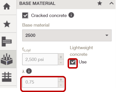

  4. Select Lightweight Concrete (Optional)
    Enable Lightweight concrete if applicable.
    When selected, the lightweight concrete modification factor defined by the relevant design code will be applied automatically.
