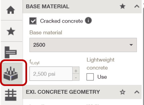

  1. Open the Installation Conditions tab
    In your Concrete to Concrete design workspace, navigate to the Installation conditions tab on the left-hand side of the screen.

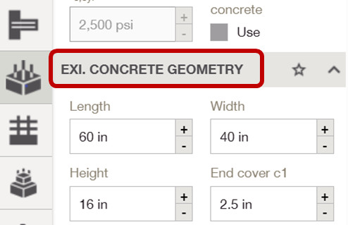

  2. Input Concrete Geometry
    Under Exi. Concrete Geometry, enter the length, height, and width of the existing concrete member. Alternatively, use the “+ / –” controls to increase or decrease the values.
    Enter the end cover.
Ensure that the concrete dimensions match the structural drawings. Even small changes in member size or end cover can affect edge distances, embedment depth, and design results — update these inputs whenever project drawings are revised.
