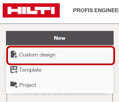

  3. Create a custom design
    Click New in the top-left corner of the screen.
    From the dropdown list, select Custom design.

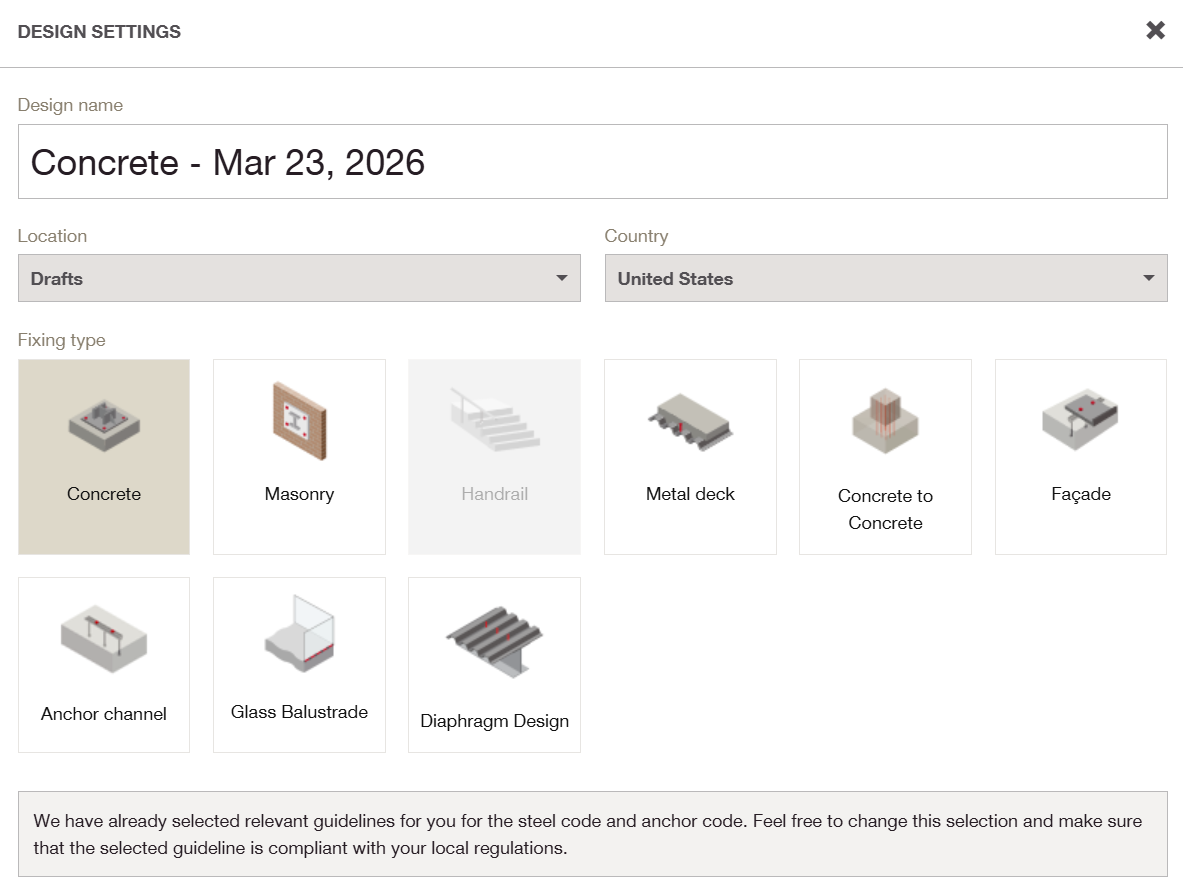

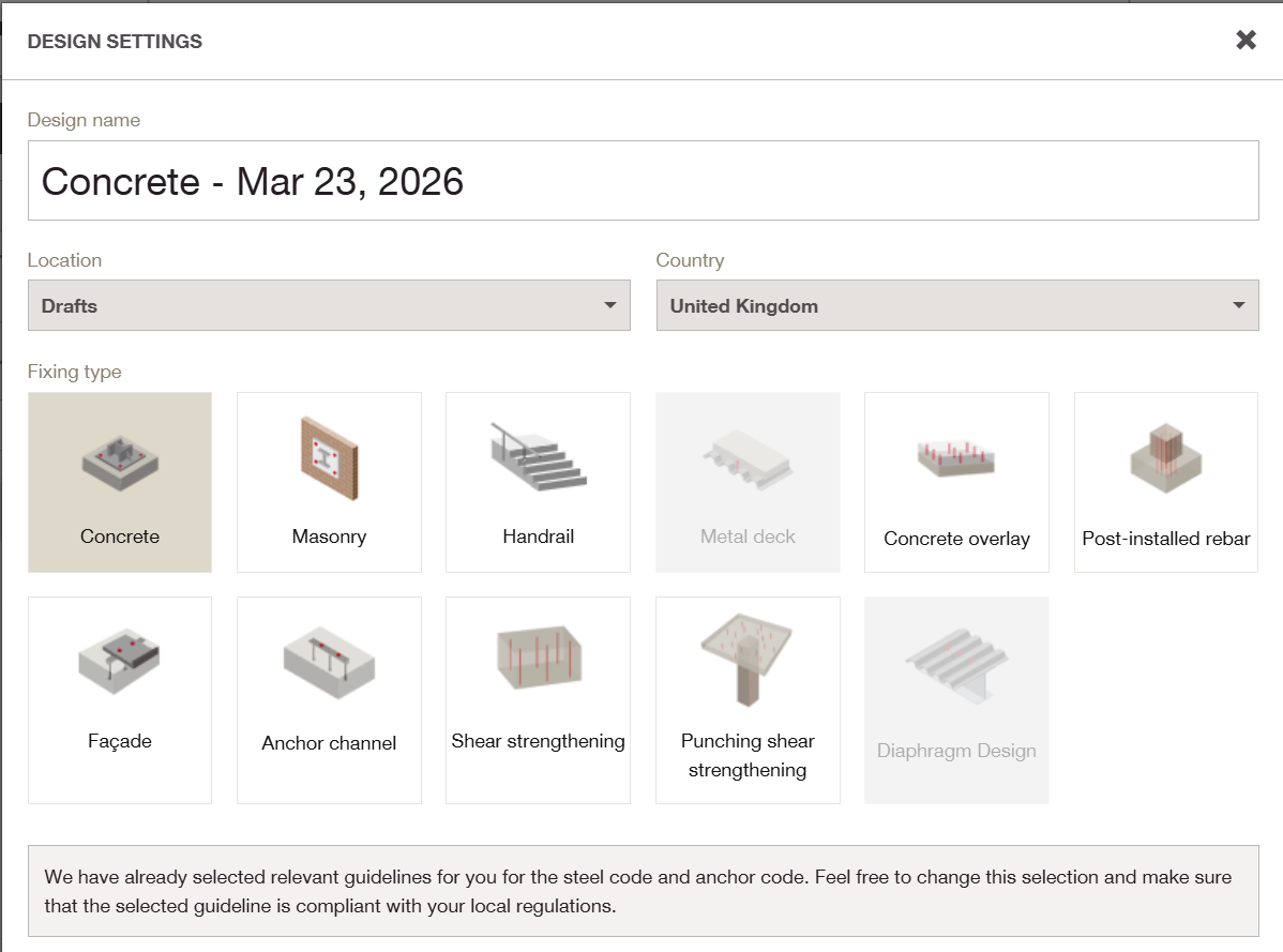

    In the pop-up window:
    • Enter a design name.
    • Select location where the file will be saved.
    • Choose your region.
    • Select fixing type (e.g., Concrete to concrete, Facade)

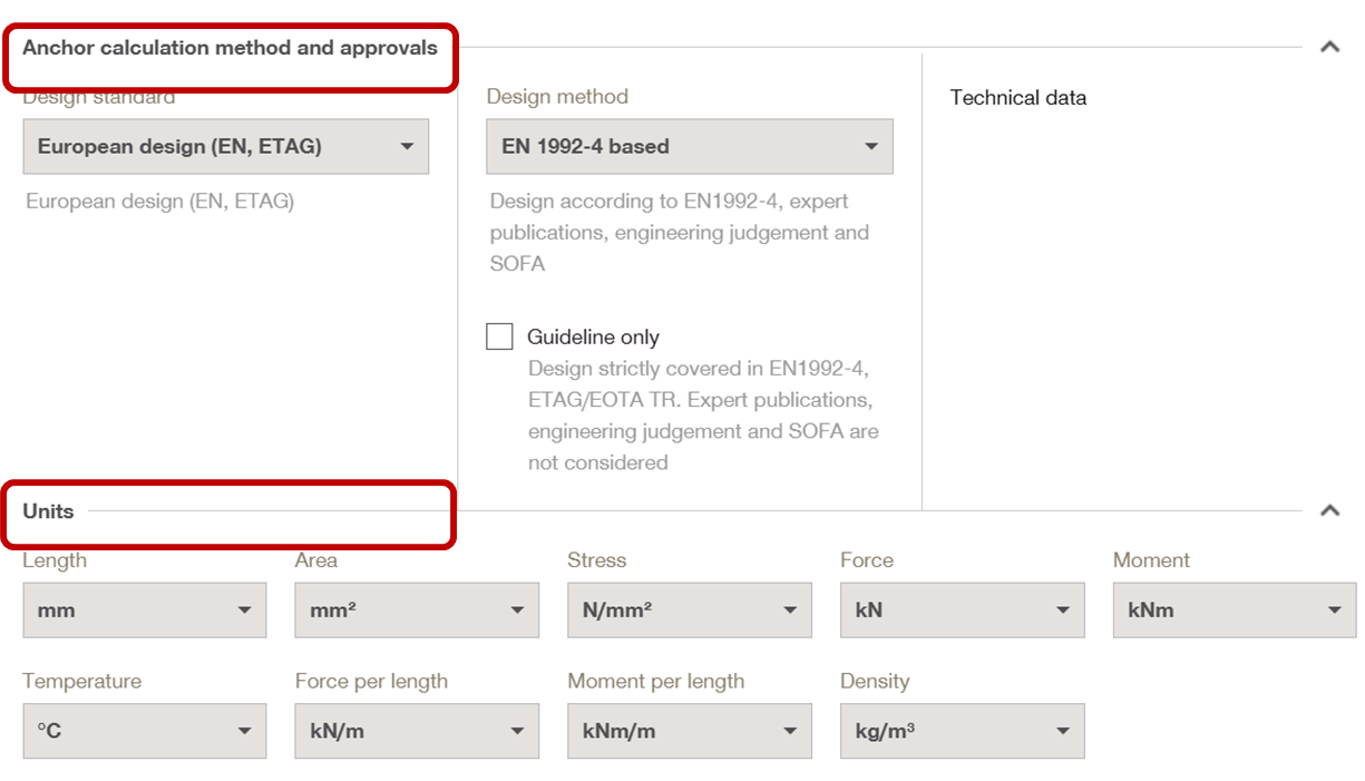

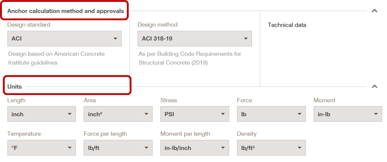

  5. Modify default design methods and units (Optional)
    In the same window, you can update:
    • Design method
    • Units
    • Safety factors and default parameters
    • Steel calculation method and parameters
    • Advanced anchor plate calculation settings
      Use arrow on the right, to expand or collapse a section.
