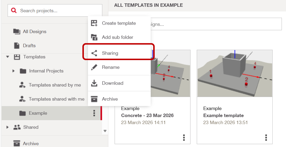

    To share a template folder:
    • On the left-hand side of the screen, select Templates
    • Click the folder you want to share.

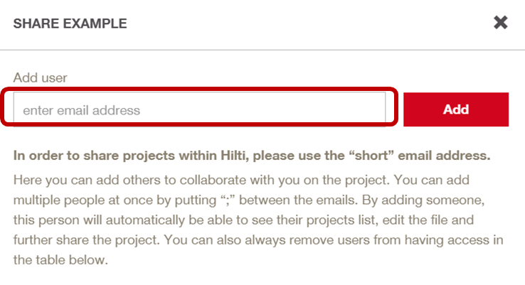

    • Click the three dots next to the folder and select Sharing from the dropdown list.
    • In the pop‑up window, enter the email address of the person you want to share the template folder with.

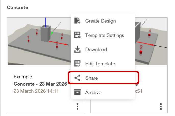

    To share a specific design template:
    • Click on the design template file in the selected templated folder.

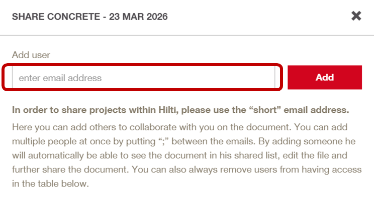

    • Click the three dots on the selected template and choose Share from the dropdown list.
    • In the pop‑up, enter the email address of the contact you want to share the individual template with.
