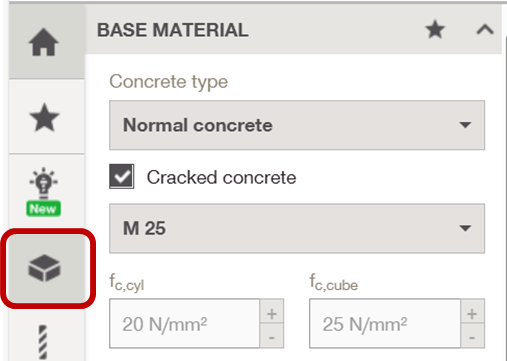

  1. Open the Base Material tab
    In your Anchoring to Concrete design workspace, navigate to the Base material tab on the left-hand side of the screen.
  1. Select concrete type and grade
    Choose the appropriate Concrete Type and Concrete Grade from the dropdown menus.
  2. Define cracking condition
    Cracked concrete option is enabled by default. Disable this option only if it can be established that no cracking will occur at service load levels.
Note: Concrete type and grade may differ depending on the country or region selected. Additionally, in applicable countries or regions, anchoring on sealing surfaces in WHG can be toggled to filter suitable anchors.
Tip
To be on safe side, choose Cracked concrete. Many concrete members experience cracking during their service life, and selecting this option provides a more realistic basis for anchor design.
