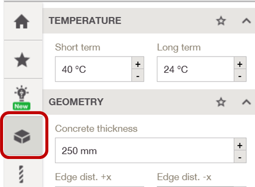

  1. Open the Base material tab
    In your Anchoring to Concrete design workspace, open the Base material tab on the left-hand side of the screen.
  1. Define Temperature
    Navigate to Temperature. Here you can type in the temperature values or use the “+ / –” controls to increase or decrease them.
    Note:
    • Short term temperature represents the highest temperature the concrete may experience for brief periods.
    • Long term temperature represents the typical, sustained temperature condition of the concrete over time, such as seasonal averages or consistently heated/cooled environments.
Tip
Define both temperature ranges carefully. These are service temperatures, not the concrete temperature at installation.  This ensures your design reflects expected service-life conditions accurately by using corresponding bond strength values for the adhesive anchor in the design.
