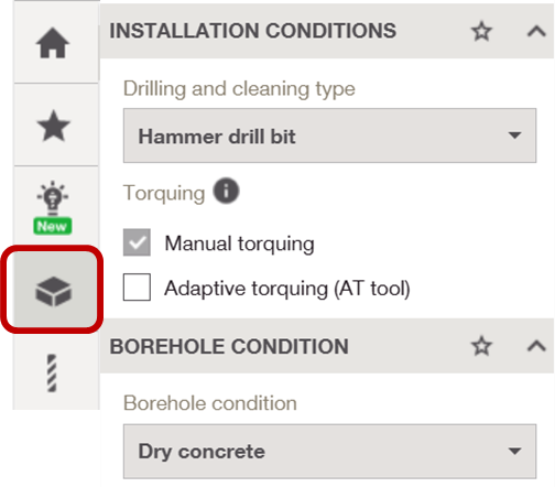

  1. Open the Base material tab
    In your Anchoring to Concrete design workspace, navigate to the Base material tab on the left-hand side of the screen.
  1. Go to Installation conditions
    • Choose the appropriate Drilling and cleaning type.
    • Select the applicable Torquing option for your installation.
    Note: Drilling type refers to the method used to create the hole in the concrete. This influences the surface roughness and geometry of the hole, which in turn affects the bond and anchor performance, thereby impacting the design strength. Cleaning type specifies the procedure for removing dust and slurry from the hole prior to anchor installation. Improved cleaning typically results in enhanced performance.
Tip
Based on the selected installation methods, PROFIS Engineering will automatically filter the applicable products. To ensure the expected performance at the job site, adherence to the specified installation method is required. Consequently, this constitutes an important aspect of the specification for the installer to comply with.
