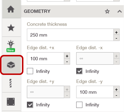

  1. Open the Base material tab
    In your Anchoring to Concrete design workspace, navigate to the Base material tab on the left-hand side of the screen.
  1. Go to Geometry
    Here you can type in the concrete thickness value and edge distances in x and y directions. Alternatively, use the “+ / –” controls to increase or decrease the values.
  2. Use the infinity edge option
    Select the Infinity edge option in case of large edge distances.
