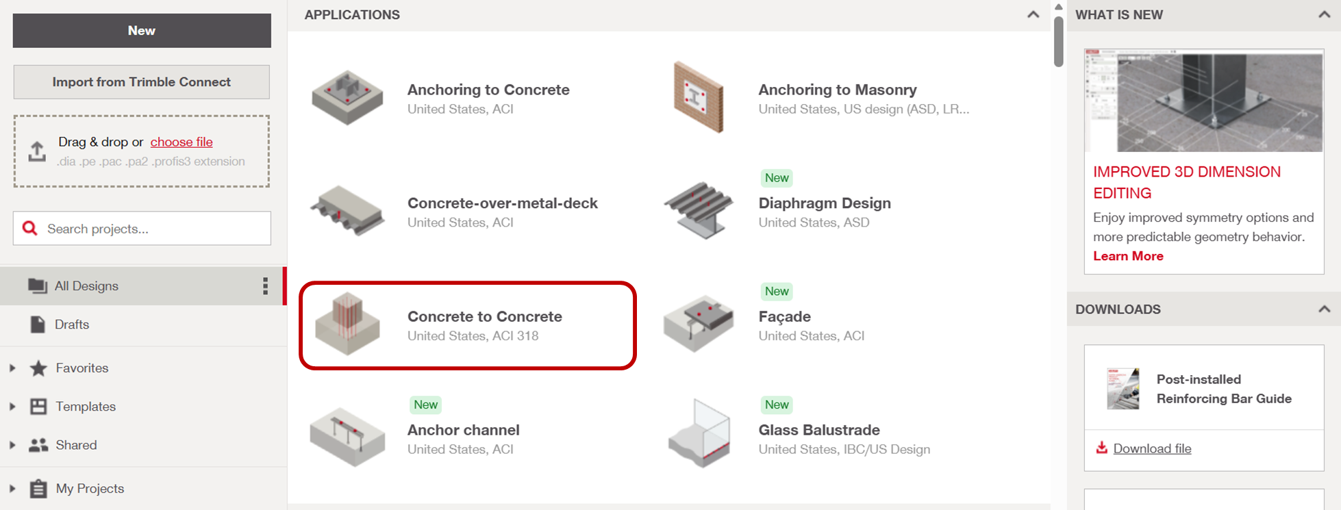

  1. Go to the PROFIS Engineering website
  2. Log in to your account
    Enter your Hilti credentials to access your workspace.
  3. Open the Concrete to Concrete module
    Click New in the top-left corner.
    From the available options, select Custom design.

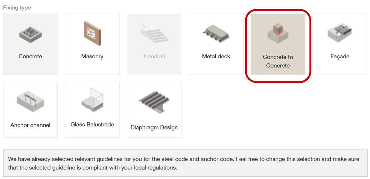

  1. Select the fixing type
    Choose Concrete to Concrete from the fixing type options and click Save.

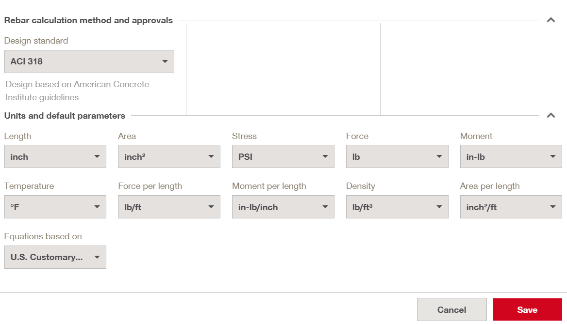

    Here you can also set your default design standard and units.
  2. Customize settings (Optional)
    If needed, adjust:
    1. Rebar calculation method and approvals
    2. Units and default parameters
    Click Save once finished.

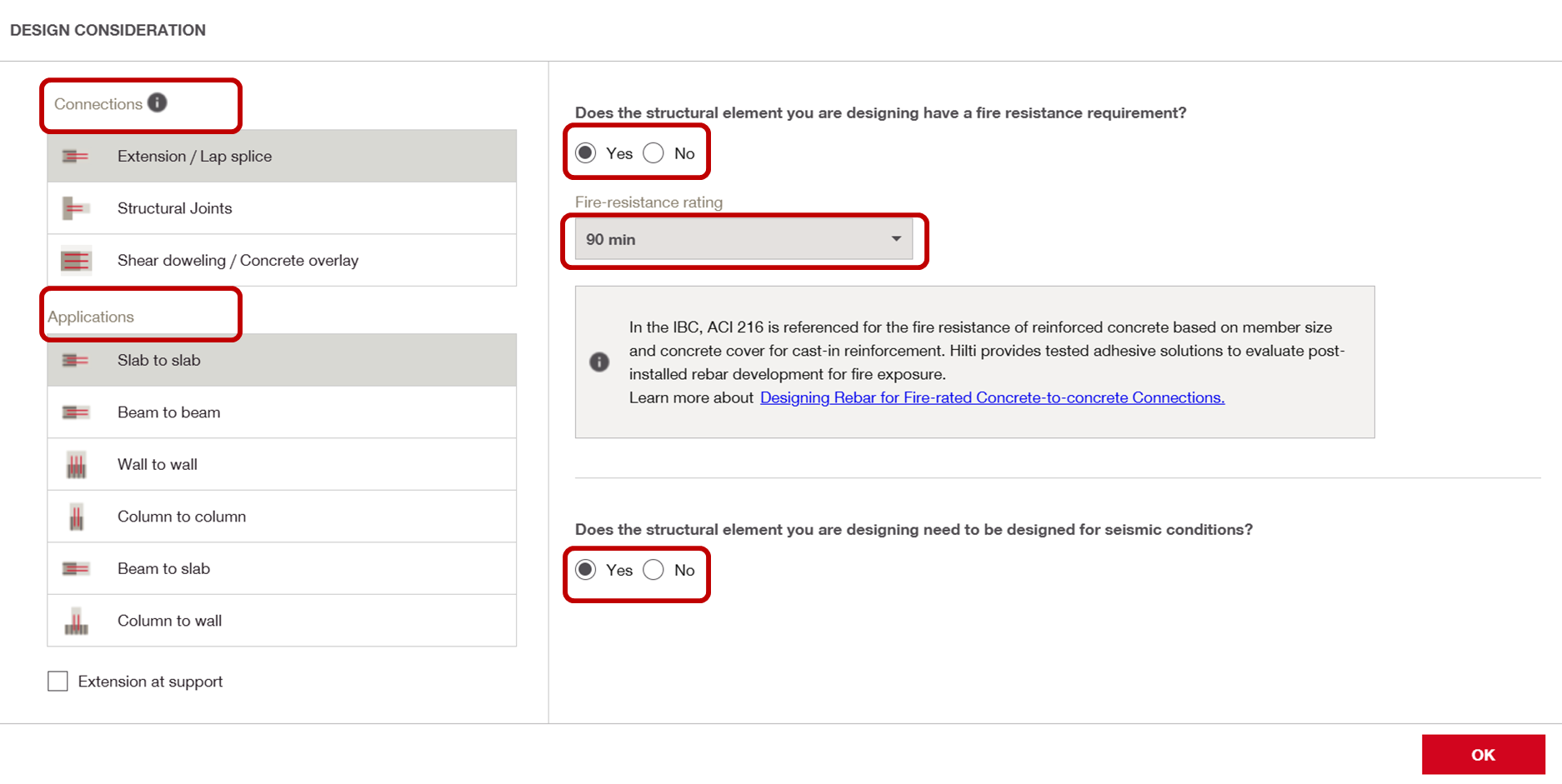

  3. Input design considerations
    In the pop-up window, select your connection type, application, and any fire or seismic requirements.
  4. Start a new design
    After selecting the fixing type and entering your design considerations, your Concrete to Concrete design workspace will load automatically.
Alternative access method
On the PROFIS Engineering home page, you can also click the Concrete to Concrete tile directly under the Applications section in the center panel.
