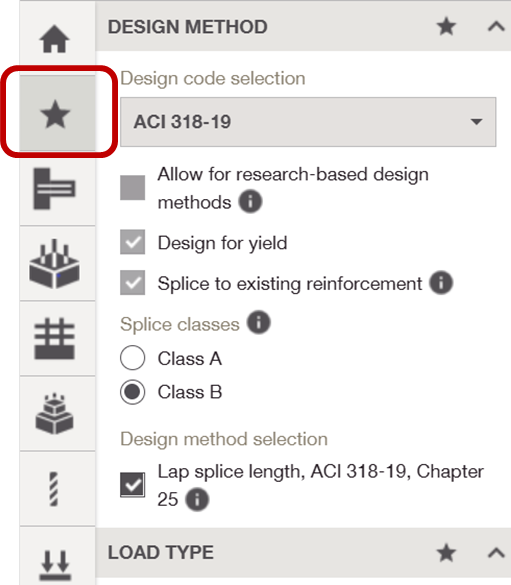

  1. Open the Favorites tab
    In your Concrete to Concrete design workspace, navigate to the Favorites tab on the left-hand side of the screen.  Here you can view all inputs currently marked as favorites.

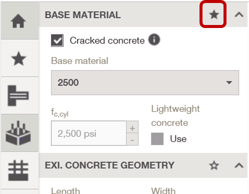

  2. Add or remove favorite inputs
    Go to any design input tab on the left.
    Click the star icon at the top of the input panel to add it to Favorites.
    Click the star icon again to remove it from Favorites.
