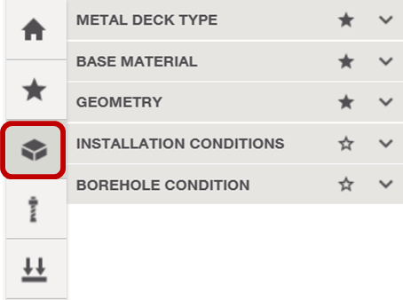

  1. Open the Base material tab
    In your Concrete-over-metal-deck design workspace, navigate to the Base material tab on the left-hand side of the screen.

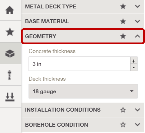

  2. Open the Geometry section
    Expand the Geometry section to view the available inputs.

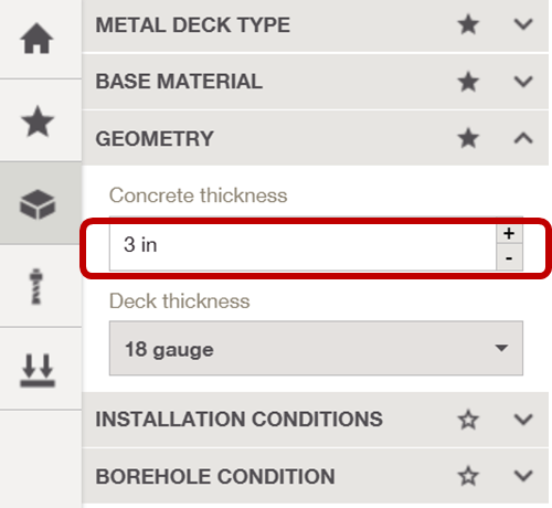

  3. Define the concrete thickness
    In the Concrete thickness field, enter the total thickness of the concrete slab above the deck.
    This value determines how much concrete is available for anchor embedment.
    As you update geometry values, the 3D model in the center of the workspace updates to reflect the change.

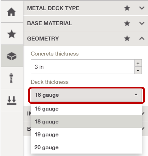

  4. Select the deck thickness (gauge)
    Use the dropdown menu under Deck thickness to select the gauge of the metal deck.
    Deck thickness affects the structural behavior of the deck and how the anchor engages with the deck profile.
