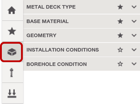

  1. Open the Base material tab
    In your Concrete-over-metal-deck design workspace, navigate to the Base material tab on the left-hand side of the screen.

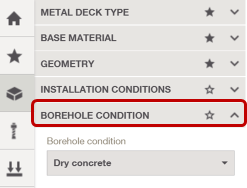

  2. Open the Borehole condition section
    Expand the Borehole condition section to view the available inputs.

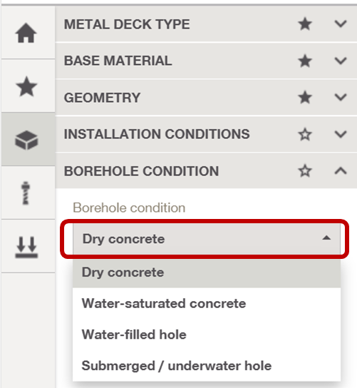

  3. Specify the Borehole condition
    Select the desired Borehole condition from the dropdown menu.
