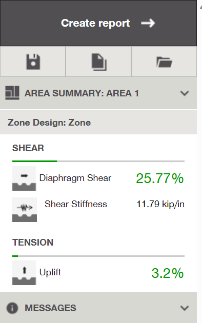

  1. Go to the Results and Notifications panel
    In your Diaphragm Design workspace, go to the Results and Notifications panel on the right-hand side of the screen.
    Expand or collapse any section using the arrow next to it.

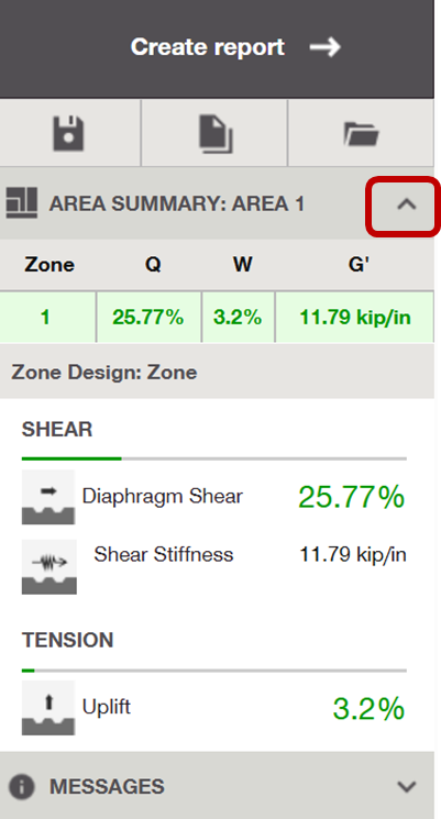

  2. View Area summary
    Under Area summary, you can review zone wise utilization.

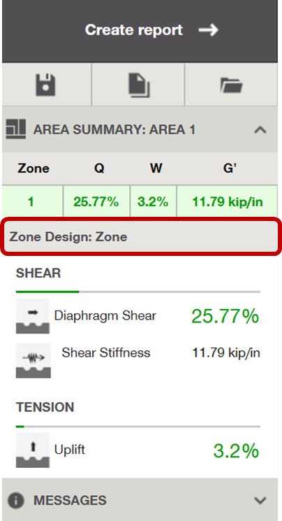

  3. View Zone Design
    Under Zone Design, you can review the design results based on your inputs.

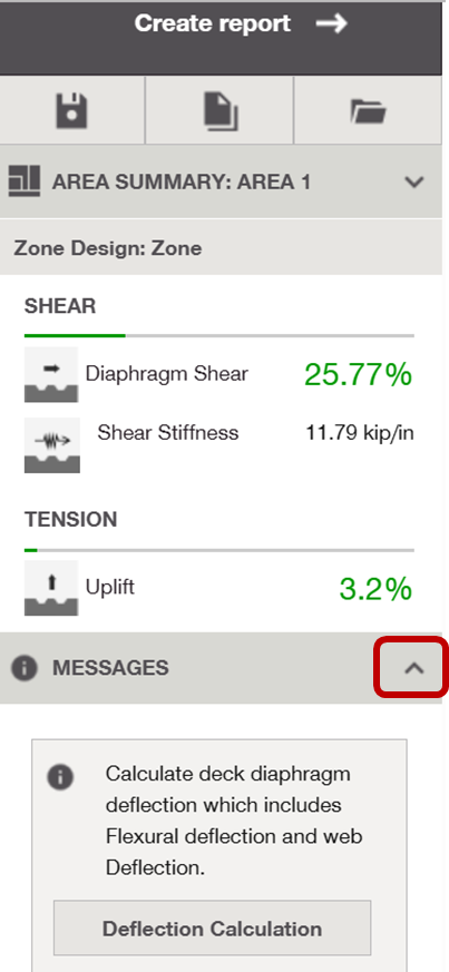

  4. View Notifications
    Open the Messages section to review design tips, warnings, and error messages.

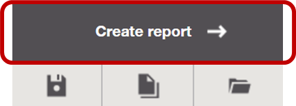

  5. Save and generate detailed design report
    Click Create report on the right-hand side of the screen.

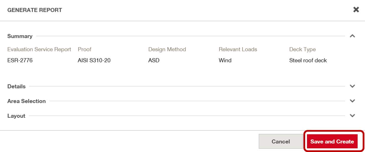

    In the pop‑up window, customize as needed, select Save and create to create a full detailed design report.
